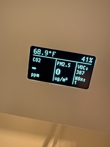

For the last many months I’ve had to frequently power cycle my AG ONE I-9PSL unit when the CO2 readings stop working. Sometimes it comes back on its own by restarting, but I usually find it in the pictured state and power cycle it.
I finally unmounted it from the wall to get logs and the only thing that’s showing up is the line “Get CO2 failed” and an incrementing count. Before that…works fine. At some point it just stops working.
The only reference that I can find online is this post about elevation compensation. I live at 3123ft (~950m). I can understand the compensation affecting the reading, but the sensor should continue to function shouldn’t it?

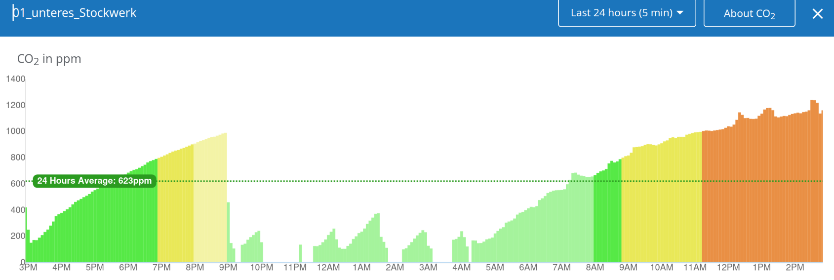

There has not been a change from my side, either in hardware or software or position. Why would I try to calibrate now? It took 8 hours for the sensor to “catch itself”, showing no or too low values. Now the last 8 hours look relatively “normal” in gain and values. I keep an eye on it and reply again if something out of order happens, like yesterday.
And here is the chart of the last 24 hours. See the choppiness since 9pm after the “closed window” phase.

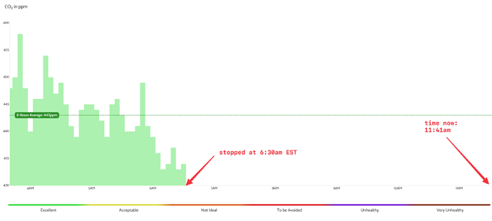

I have this problem now with my I-9PSL-DE (running 3.3.6)
I’ve had the unit plugged in and stable for about 2 months now, suddenly the CO2 reading is null. I haven’t power cycled yet, is there anything I could/should do?
Last 8h
