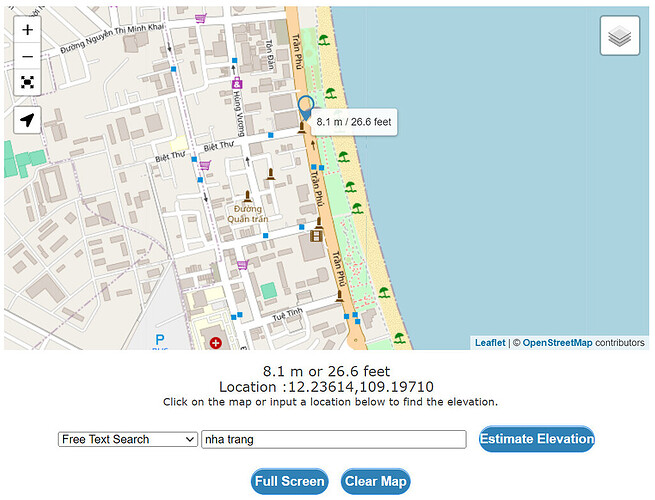

I’m considering purchasing an Air Gradient One for measuring air quality in my child’s bedroom during the night, and my office during the day (I work from home). I live in a city with high relative humidity throughout the year, and at 800m above sea level.

If anyone wants to learn more about this, I’ve done some testing at 1500 metres altitude, and the difference between an air pressure-corrected CO2 sensor and a non-corrected sensor appears to be quite significant!
