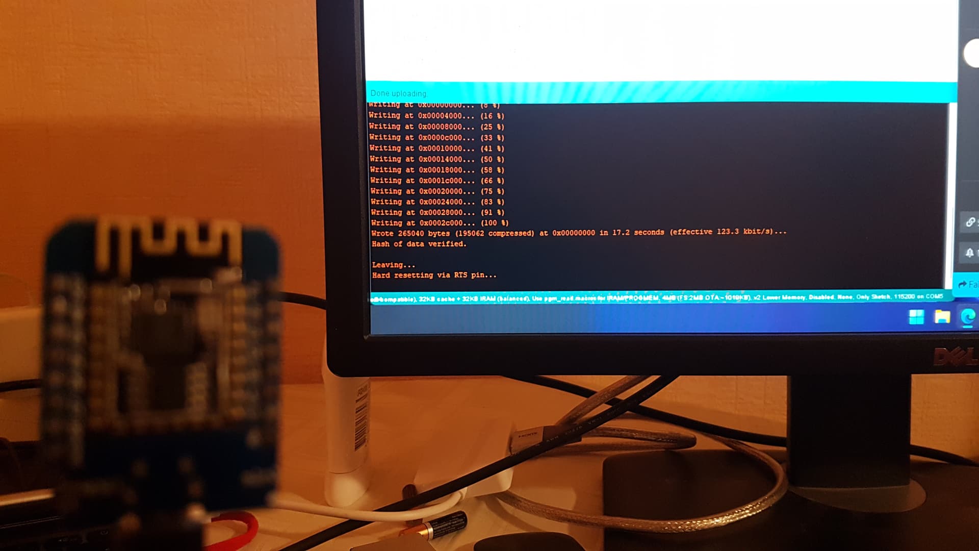

I have a news :facepalm:
Blink successfully uploaded.

It’s strange, but i uploaded big sketch without any issues.
Soon will solder it again but this time it will be detachable. Will be back.
Guys, thanks to all, problem is gone

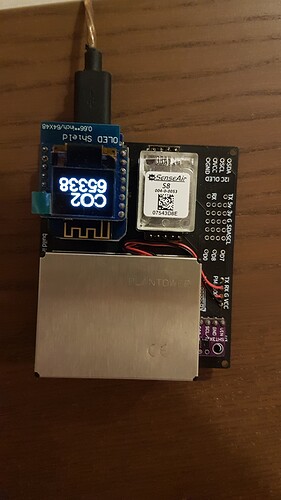

Your CO2 looks way too high. Sensor only delivers a range of 0-10.000.
Do you still have so high values?
@Achim_AirGradient, the values jump

Today it freeze on 65338 :frowning:
Tried to calibrate him by _bCal, after 5 minutes of adequate working the value back to 65338.
if you blow on it with breath, it shows something similar to the truth, but by default his back to this strange value.
What could be wrong?
This is really weird. Never had that issue. Maybe the S8 got damaged through the over voltage?
I’ve done this quest :slight_smile:
Soldered on second PCB, on this time removable.
The clearance between airgradient sensor and pcb is much bigger.
Reflashed, reset bCAL_ and it’s back to life.
