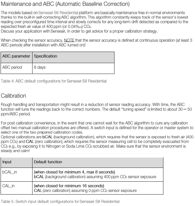

On another point I read it takes the Sense8 sensor a week or so to self calibrate . . . is this correct?
The Sensair S8 Residential sensor user guide is here: https://rmtplusstoragesenseair.blob.core.windows.net/docs/publicerat/PSP107.pdf
This is what it says about the ABC (Automatic Baseline Calibration) and calibration:
Each ABC period is 8 days. It basically assumes the lowest readings over that time period is fresh air (400ppm), so it will slowly calibrate itself to that lowest reading.

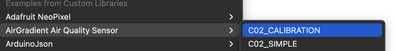

Additionally there is also an example in the AirGradient library to make an immediate calibration to 400ppm.
 This is the code for forced calibration of the SenseAir S8 sensor. The sensor also has a one-week automatic baseline calibration that should calibrate the sensor latest after one week.0
 However if you need a faster calibration please proceed as following:
 1. Flash this code
 2. Bring the sensor outside into fresh air and leave it there for at least 10 minutes
 3. Power on the sensor
 4. Follow the instructions on the display
 5. After the calibration has been done, flash back the previous code for AQ measurements
 The codes needs the following libraries installed:
  “S8_UART” by Josep Comas tested with version 1.0.1
  “U8g2” by oliver tested with version 2.32.15
Many thanks to Josep Comas of the S8_UART library from which parts of below code are borrowed.
