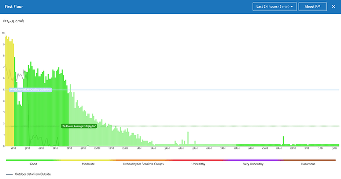

I’ll upload screenshots for comparison. Annoyingly the forum doesn’t let me attach multiple images to a single post, so I’ll have to make multiple posts. Here’s the AirGradient Dashboard for the last 24 hours:
Here’s the Home Assistant data for the same period:

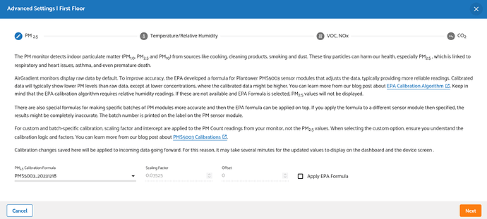

I’m not sure if I have my settings correct. I do have the right PMS5003 corrections selected in the AirGradient Dashboard, but I don’t have the EPA checkbox selected. I’m not sure if that is needed or if it is recommended. In Home Assistant, I also have the device set to “Local configuration” instead of “Cloud configuration”. I’m not sure if this makes a difference. Here are screenshots of the two configurations:
I’ve also noticed that the home assistant PM2.5 data seems very spikey, with lots of zeros in-between data points. This doesn’t look right to me, compared to the AirGradient dashboard.

Ah, so the local server docs suggest that if you’re using the Home Assistant integration the configurationControl setting may be set to local which appears to mean corrections changes you make in the dashboard don’t get applied automatically to the device itself:
If configurationControl is set to local (eg. when using Home Assistant), correction need to be set manually, see examples below
Indeed, my unit is set to local, monitorDisplayCompensatedValues is set to false and there don’t appear to be any correction algorithms configured.

Thanks for the responses! After setting the configuration source to ‘cloud’, as well as updating the configs in the dashboard to enable the EPA algorithm, the numbers seem to be matching.
