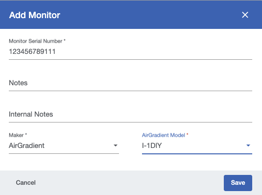

Serialnumber is now 12 digits. So you need to set it up again as new hardware on the AirGradient dashboard and then link the exsting location to the new hardware.
Go to: AirGradient then click “Add new”

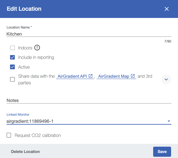

Then change the Linked Monitor in Location Settings to the new serial number
https://app.airgradient.com/settings/location

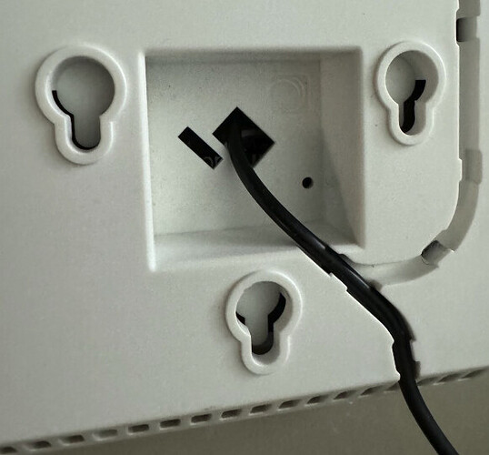

However what you can do is to get a USB C cable with a straight plug, feed it through the larger rectangle hole on the enclosure directly into the D1 mini. Then you can flash it this way without opening the enclosure.

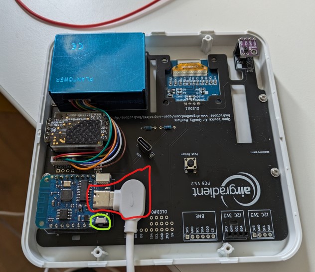

I am trying to flash my pcb 4.2 board through the mini port.
I have used three different USB-C cables, and both Edge and Chrome and have also tried to press the middle button on the pcb board. I get this result every time. I also don’t know how to reset the board…
Any help please :slight_smile:
board
With the 4.2 board you have to plug directly into the chip inside, you can’t use the external USB port
Before plugging in the cable, press and hold the reset button on the D1 Mini board and plugin your USB cable
The try to flash again
Please check the image. Red circle is the D1 usb-c port, correct?
And the button we are talking about is the green circle?
So I press the green button and then insert the usb cable. I have hold it for 5 seconds and like 60 seconds. When I let it go it starts the normal boot process that asks med to connect to the wifi.
If I try to install the beta firmware through Edge i can just plug it in, press the button for like 5 seconds or keep holding the button for a long time. Nothing really changes. I get the same error and when I let go of the button it starts to go through the boot up process on the screen.
I am very confused. :smiley:
These drivers were missing: Okay I can’t post a url but if you google “CH341SER zip” its the wch-ic com domain
It works as expected now. These things are maybe obvious for you guys, but it was not for me :smiley:

FYI. The instructions for changing from the short to full MAC address didn’t quite work for me, so I wound up with a new device and a disconnected old device. The serial number drop down under Linked Monitor only shows the old 6 digit MAC.
I just did this, and it worked well for the most part. It boot-looped initially, but I’m not sure why. I vaguely recall it asking for initial unit settings (C/F, etc.). Pressing the button on the D1 and re-flashing then worked.
I also didn’t create a new device in the AirGradient dashboard–I just updated the serial number on the existing device, which seemed to work.
